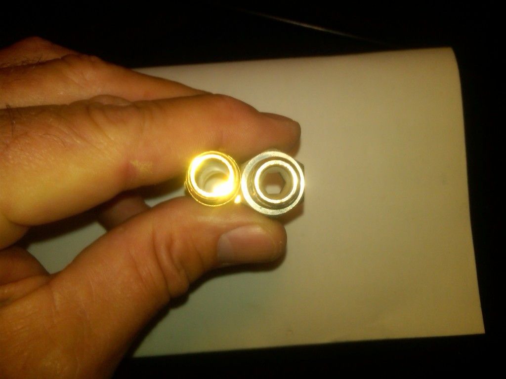

Been tweeking the setup the last few days. Bought a leader hose and installed that. I had previously said the horn inlet was 3/8". It is not. I had a 3/8" push connect fitting in it with 3/8" OD hose. The hole is 1/4" NPT. The 3/8" push connect fitting inside diameter is 7/32" (hex shaped). A 1/4" pipe nipple is 5/16" ID. :smiley: I replaced all the push connect 3/8" fittings and went with 1/2" compression fittings and 1/2" OD hose throughout. Should be a significant increase in air flow to the horn. Letting the last of the fittings sit for a day to set (used pipe sealant vs the teflon tape). It’s hard not to go fire it up but I’m trying to be patient.
I hope it improves for you. At least you don’t have to wonder any more.
