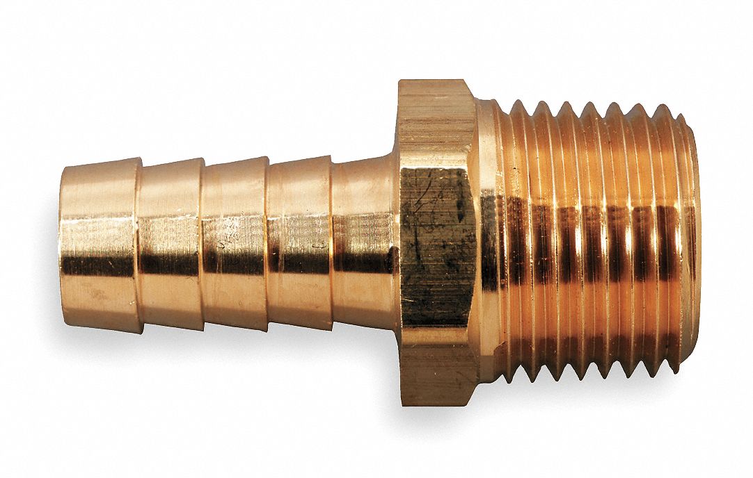

The barb connector is 3/4" (fitting) but metal seems too thin… i don’t like it.

The only chance i have is to find some 1/2" barb hoses and then i can look for the pipe. Then tight it up with clamps. Snap-in connectors are useless and hard to find for that size.

I went to the shop i usually go to and i insisted to see the barb hoses.
I found a 1/2" brass hose with .79" ID and then found the correct pipe.

I went to the shop, bought the pipe, the hardware to fit the pipe to the barb connectors, a 1/2" T and a 1/2"-1/4" reduction.
For the tank i used another bigger fire extinguisher, but this time i welded a 1/2" female on it.
Then i used the female T with a nipple, on one hole i put the barb and on the other one the 1/4" reduction for the compressor.
Then i passed the pipe all under the car from the trunk to the engine bay and then i connected it to the solenoid. The solenoid directly to the cross. Then i used three 18" small pipes for each horn.
