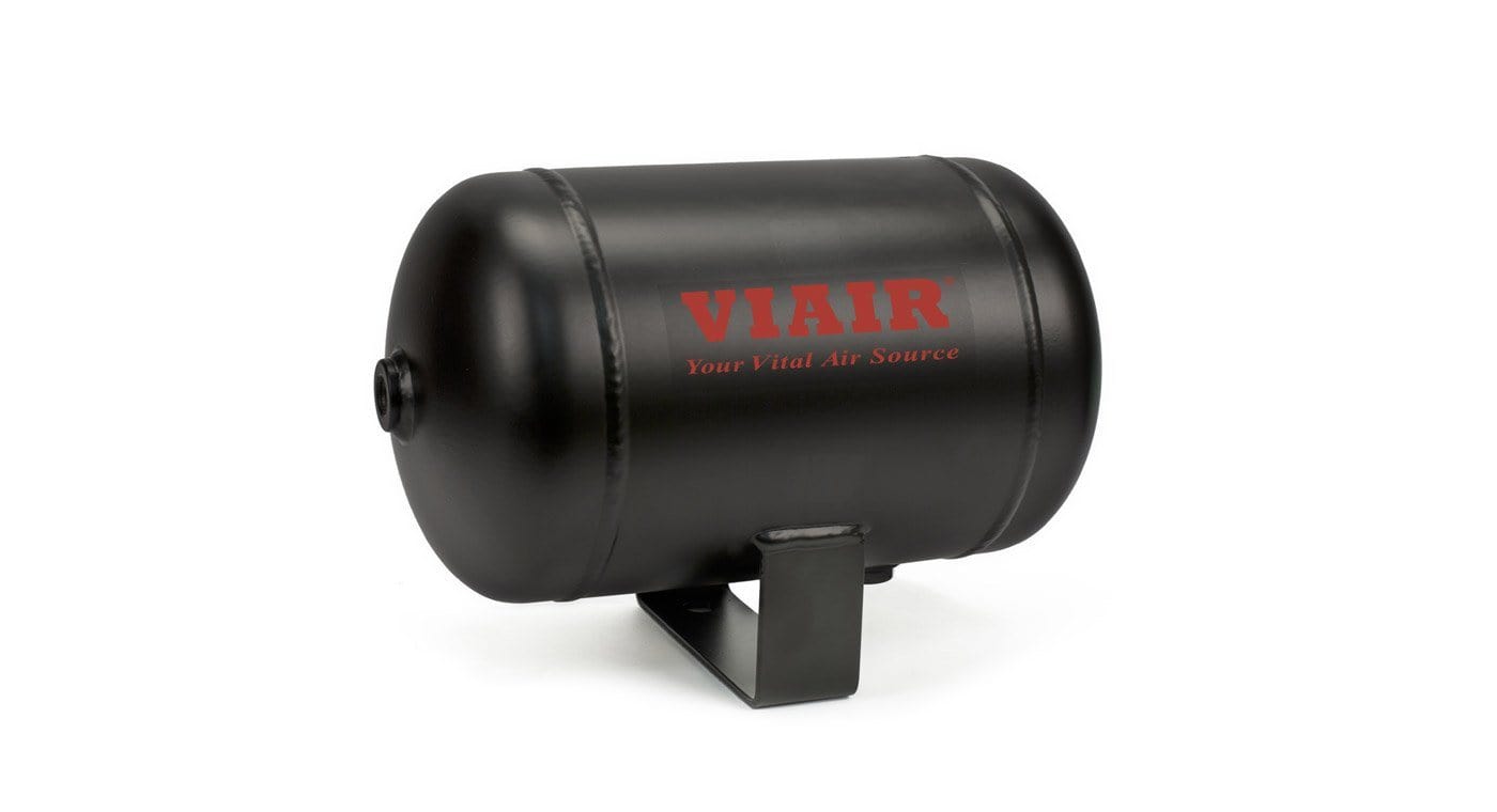

Hornblasters has some Viair 1 gallon tanks.
There might be others out there that are shaped differently.
