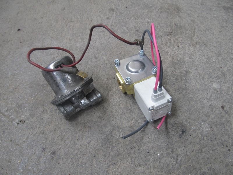

here’s a pic of the original valve:
the original valve has an orifice measuring a whopping 3mm!!! :eek: (I measured it) so if my horns wanted more air, this is the bottleneck.

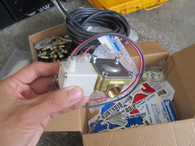

so now I bought the Chrome 3/8" valve from HB. the valve is a bit heavy and bigger than I was expecting. but luckily, it fits. and there is barely enough room.
A habit of mine is to open things when I get them. no more warranty, but for the price, it is much cheaper to buy a new one than send this back if it breaks. so I looked around inside the valve. orifice measured 5mm. the coil is not potted so it could be rewound if needed. there is a generous amount of iron and copper inside so 2amps at 10V is enough to open the valve. (the same voltage and current rating supplied to my previous valve wasn’t enough to open it even without air pressure) haven’t really noticed what material the base (where the fittings go in) is made of. probably cast brass since it is a bit heavy to be cast aluminum. the coil cover is steel (and there are more iron inside for concentrating the magnetic field of the solenoid) and the screws holding the cover are stainless steel.

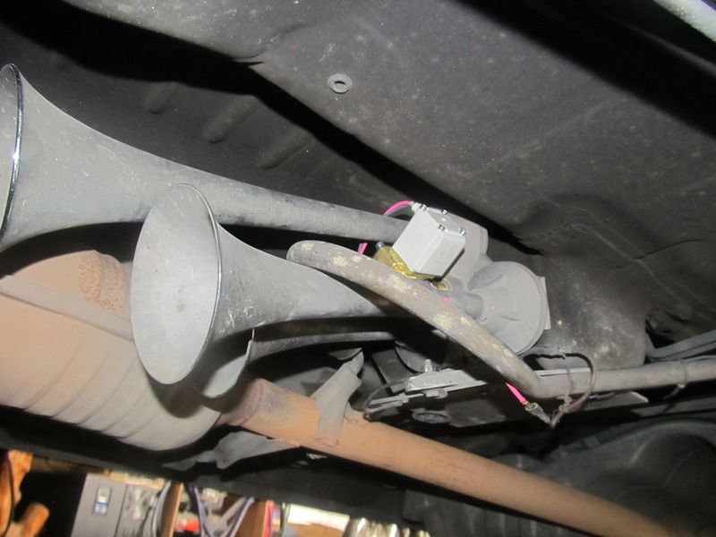

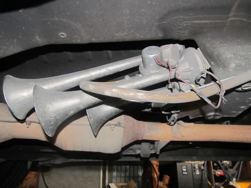

here’s a few pics of the chrome 3/8" horn installed:
as for performance, I have a gauge in the dash and observed that it takes even less time to drain my massive 2 gal tank.
haven’t used it that much so I can’t really say for sure that it is louder. but it does seem to be louder and the tone changed a bit. pressure tested was up to 125psi and it opens easily and quickly. short honks are no problem and there is no delay from the push of the button to the sound coming out of the horns.
