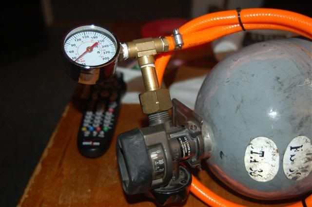

The following are pictures of the tank i will be using. It is a 30 min SCBA air bottle that is rated to 3000psi, obviously i wont be using that much air, but at the very least i know that it will hold 200psi without complaining.
the 30 min tank is roughly 514 cubic inches which comes to about 2.2 gallons.
Rigged it up so i can test it.
Side by side with my 20lb CO2 tank.
ru using nitrogen?
Manual valves rule.

no, im not running nitrogen. im running compressed atmospheric air. i was able to get the tanks cheap so why not?
one or both of the tanks will be mounted in the cargo area where the spare tire used to be.
