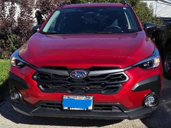

We just got a 2026 Subaru Crosstrek with a wimpy factory factory horn that just says “excuse me…please”

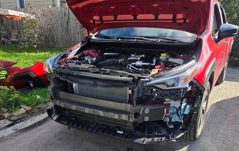

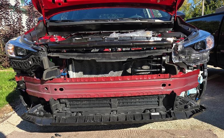

Here is the front end with the bumper cover off, ready to dive in.

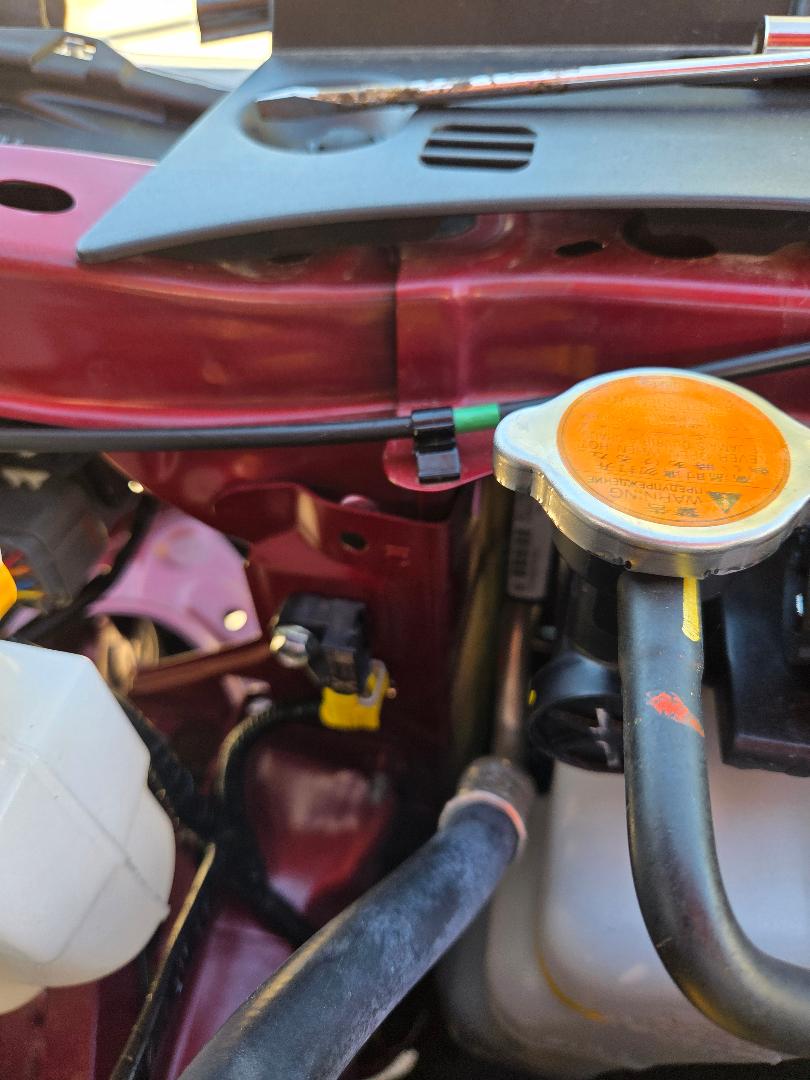

This pic shows a convenient hole to mount the compressor.

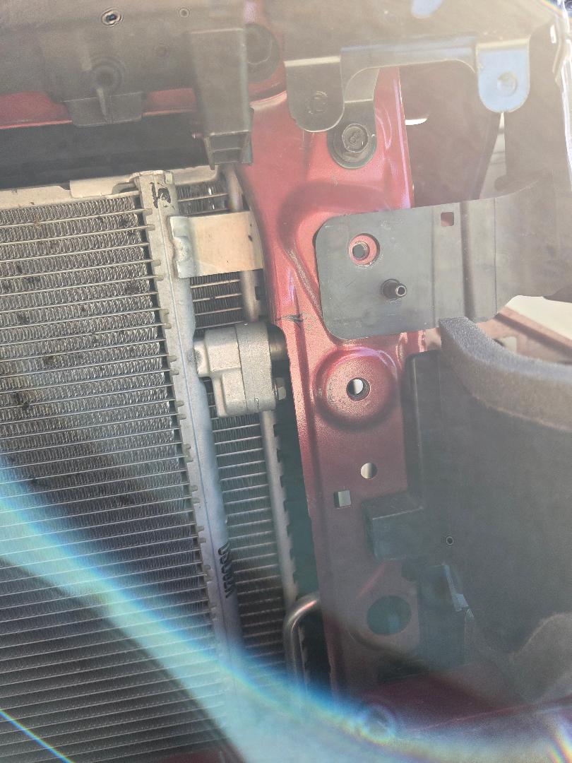

This pic shows 2 convenient holes just below the black plastic part. These will mount the horn with a custom bracket.

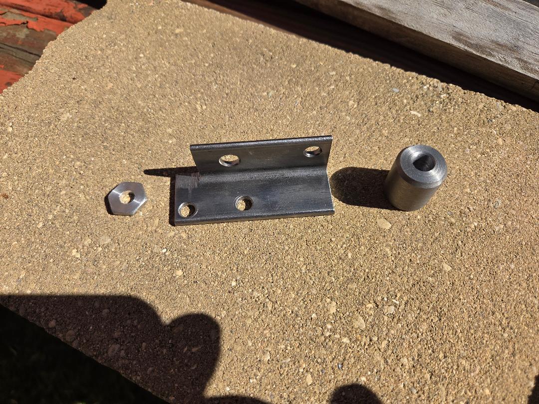

These are the custom parts I had to make. Left is a spacer for the horn bracket since one of the holes on the car is raised, center is the bracket for the horn made from 1x1x1/8 angle iron. The part on the right was made to space the compressor out for clearance of an electrical component.

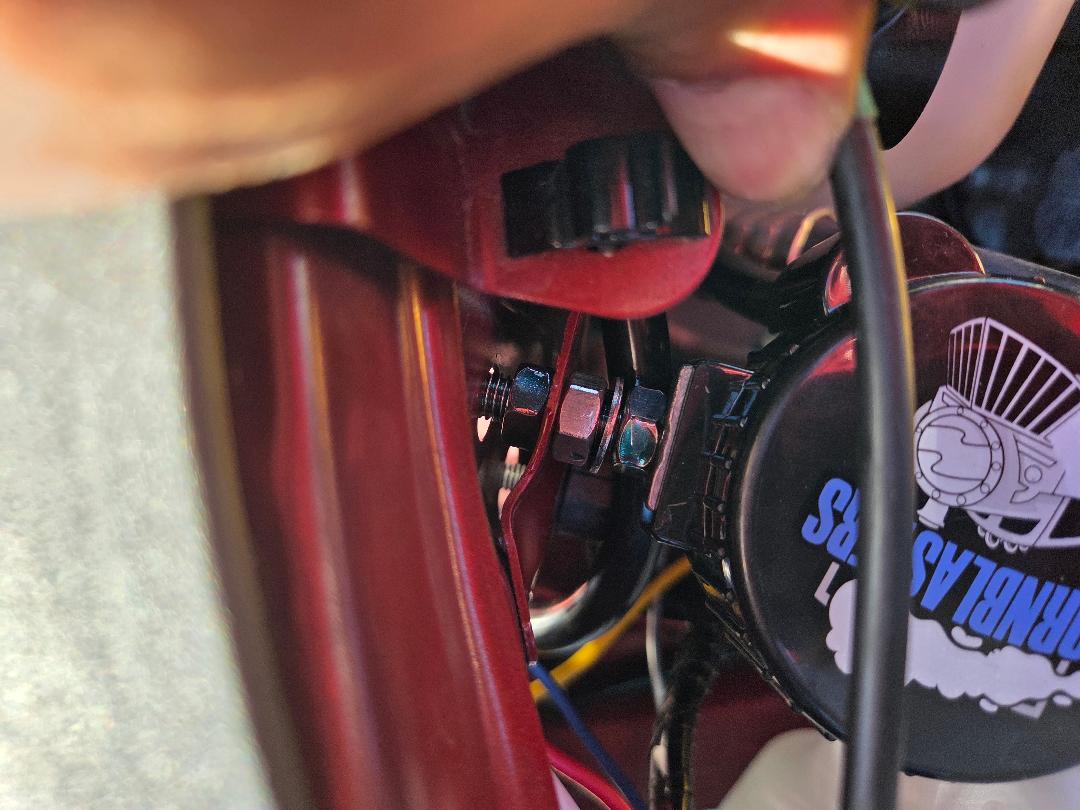

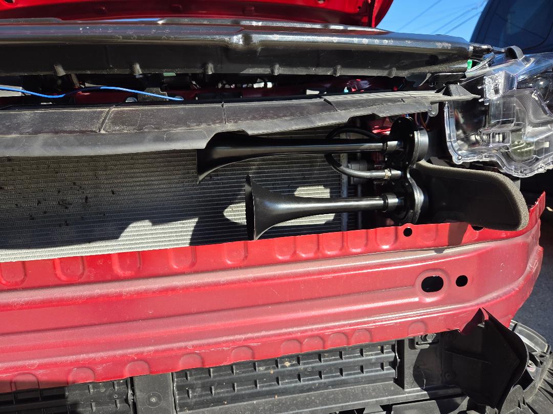

This is the horns bolted in place

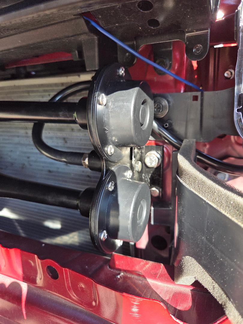

A better pic showing the horn mounted to the custom bracket.

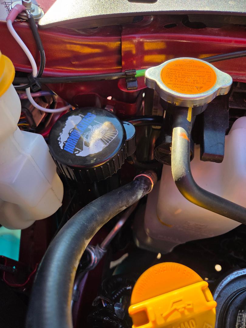

This is the compressor mounted in place using the existing hole.
Here is a closeup showing how I mounted the compressor using a longer bolt and 3 nuts instead of the spacer shown above.

All buttoned up, Sounds way better than the stock horns, I left the stock horns in and connected but you can not hear any part of the stock over the PsychoBlasters.

for the wiring I tapped into the factory horn wire at the horn that is behind the right fog light. I ran that tap wire to the coil of the relay so the extra draw on the horn circuit is very little and the car does not seem to notice it.
As for the mounting, there were zero mods done to the car other than splicing into the horn wire. there were already 2 factory unused holes in the vertical radiator frame that I used to mount the horn. I did have to make a custom mounting bracket out of 1.5 x 1.5 x 1/8 steel angle (that is what I had laying around) There is just enough space between the bumper and the AC condenser to fit the horn bells with no mods to anything. There is about 3/8 inch clearance front and back of the bells. There is a pic of the angle bracket in a post above and another pic showing the 2 holes used to mount it. Those 2 holes are factory holes so no drilling was done. One even conveniently had 8mm threads in it.
