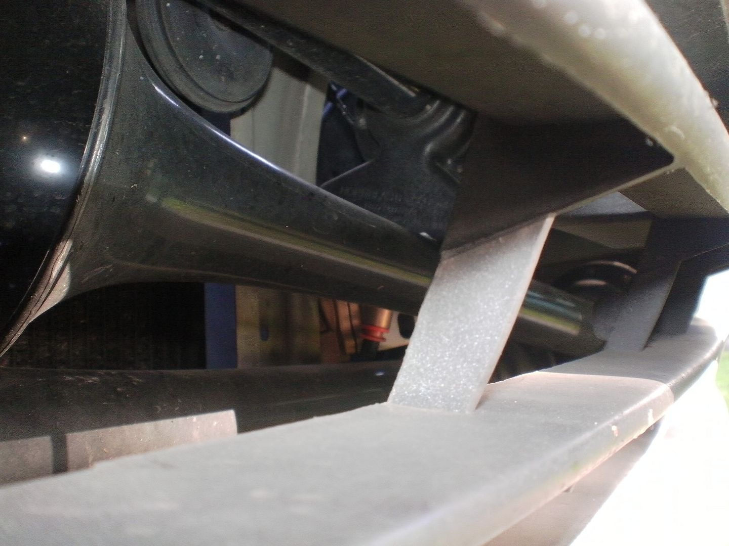

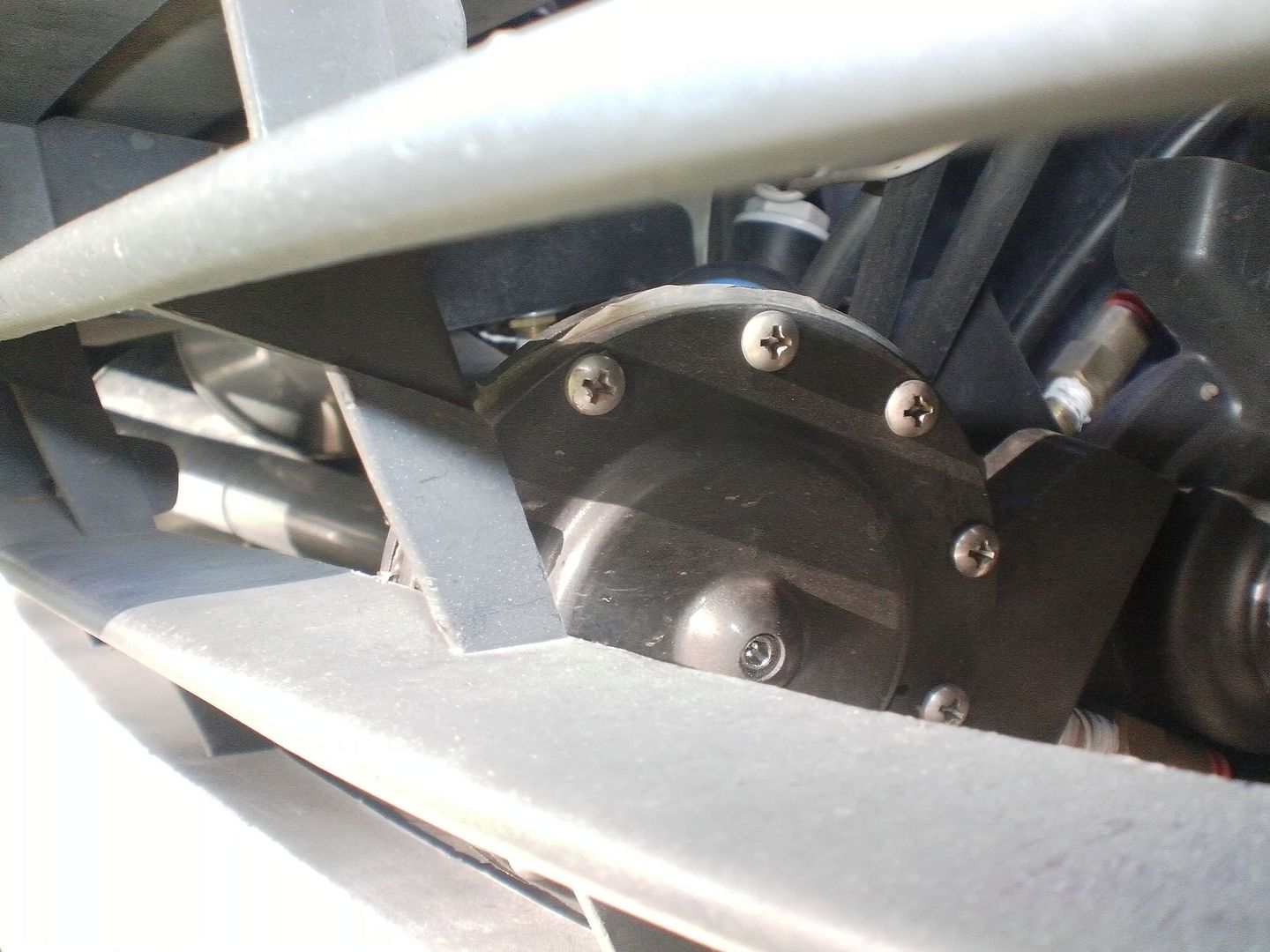

Your best bet for ease of finding a location is if you get the Shockers, the 4-trumpet black plastic ones on hornblasters. They have the advantage in that the trumpets are smaller in diameter and the trumpets aren’t connected to a manifold so they can be separate. It will be very likely that you can place them inside your front bumper, in front of the radiator, at least they fit there easily in a 6gen '99 Civic (http://i909.photobucket.com/albums/ac295/danwat1234/Shocker%20240%20hornblasters%20kit%20on%20Honda%20Civic/SANY0026.jpg)(http://i909.photobucket.com/albums/ac295/danwat1234/Shocker%20240%20hornblasters%20kit%20on%20Honda%20Civic/SANY0025.jpg)
The genuine train horns, you’d need to mount them on the roof, under the trunk(http://www.youtube.com/watch?v=JYqHa_40jKE), or separate the horns from the manifold, there are guides on here I think.
Username ‘honduhh’ has put a Nathan K3 in her car’s rear bumper by separating the horns…see the photobucket link in previous posts

Under the bumpers is your best bet
