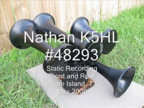

That would be a K5HL then … here’s some clips:
