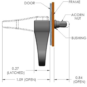

I’m thinking of using a “Swell Latch” something like this:
or,
