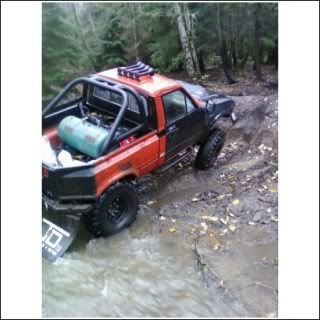

im sure your truck is a little prittier than mine but i mounted mine ontop my cab but i havnt run into any problems yet…i dont know where to mount on your truck but when i put all my stuff together, i just made sure the compressor would stay dry so i put it inside my cab. and put my tank in the bed.
the only problem ive had with the horns uptop is when it rains, they get water in them and they quiet down but once i hold it down for a sec, it clears out and theyre back to new!
Sounds like that would work best for an offroad setup for sure! How did you mount the horns to your roof? Just drill through and bolt it on or what? And does the compressor make lots of noise in the cab?
yea just drilled through and bolted…its more than less my wheelin toy, so looks or what ever isnt a big deal. but i still drive it almost daily just cause i like it. but the compressor can get a little noisey but if im cruising down the road at 50mph, my truck has so much road noise, i hardly hear the compressor.
or if i dont want to hear it, i just turn it out and go inside the house for a few and come turn it off. i didnt put a pressure switch on it…just a pressure gauge up front and a on/off switch
