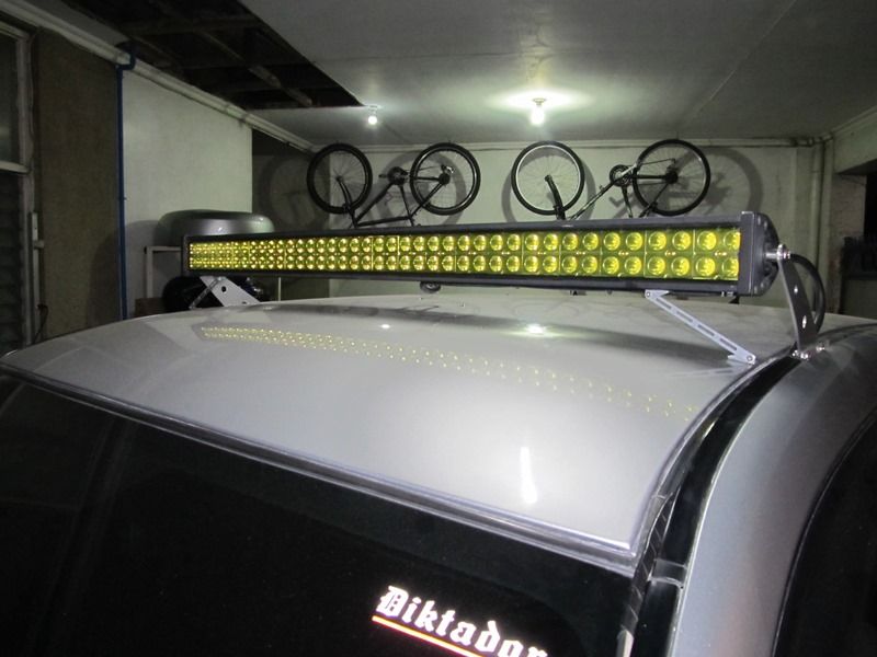

Here’s some stuff I have been doing to my car lately.
I tinted my 240W led lightbar yellow to hopefully have better visibility in the rain or fog. I have had the lightbar for a while now and is attached using custom aluminum alloy mounts that I made that bolts on factory roof rail holes.

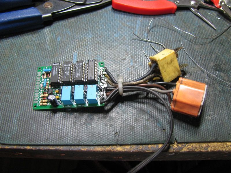

My lightbar is controlled by this board which is linked to my headlight blinkers with some timing and delays so that it will only work when I need or want it to

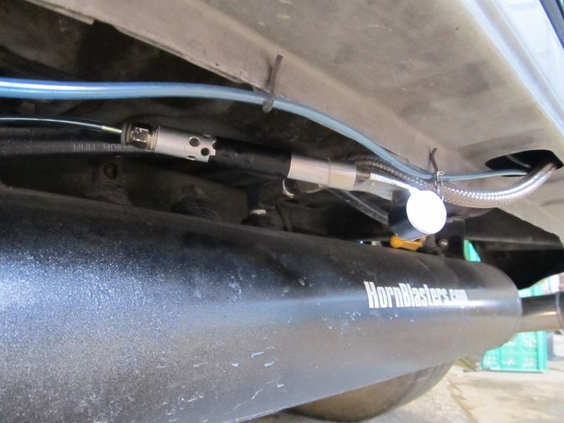

And while you are all busy with train whistles. I just added a police whistle on mine.
OK, you’re going to have to give us a demo of that whistle in action.
What’s that silver gizmo with the holes you got in front of the whistle?
^^^ agreed! We demand to know!![]()
HAHA… you tell it like it is ![]()
If I had to guess Stinky, it looks to me like a home made way to bleed off some excess air pressure before it hits the whistle. Maybe a bit of round pipe flatted on one end. Full tank pressure on the whistle is probably too much.
I guess the main man will tell us soon enough ![]()
It’s a way to convert the 130PSI tank high pressure, low volume air into low pressure, high volume airflow.
Too much air and it doesn’t sound like a whistle but rather a distorted whine.
It uses a 4mm air tube into a thin brass tube with about 0.5mm hole in it. The high velocity air coming out sucks air from the side holes and moves a lot of low pressure air. The black tape is my temporary way of adjusting air volume going into the whistle for best sound.
It uses so little air that the 2gal tank lasts forever
