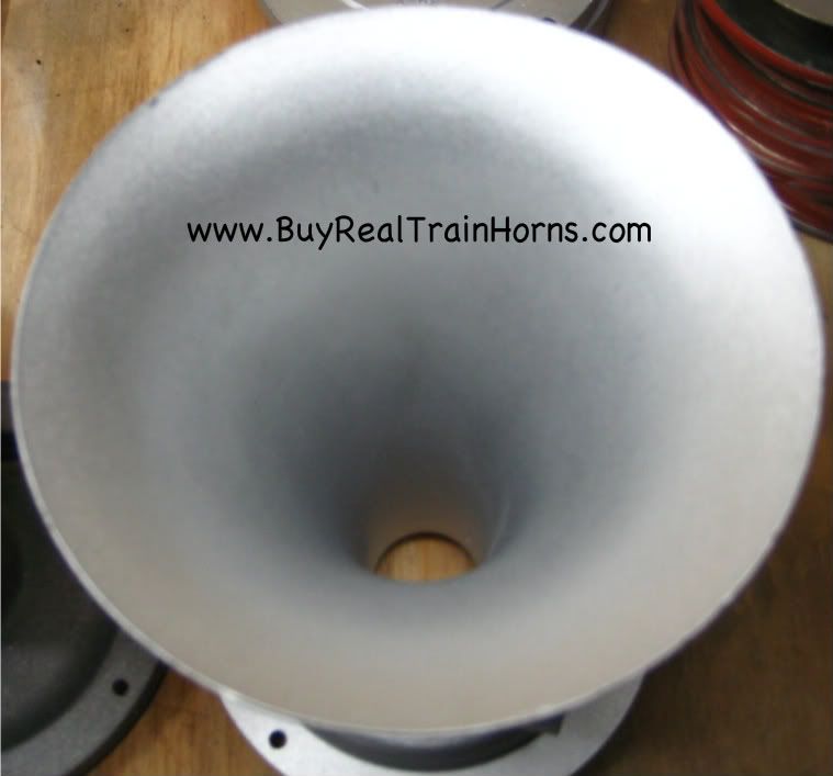

Sand cast removes 95% of the factory defects, leaves the horn in a state thats perfect for painting or powder coating. Glass beaded is perfect for clear powder coating, or polishing. Just the sand cast version alone puts the horns in a better state than stock for defects.
Powder coated.
Before
After.
Before
After. Sandcast style.
Glass Beaded.
See. :slight_smile:
cool they look better for sure
Even better.
