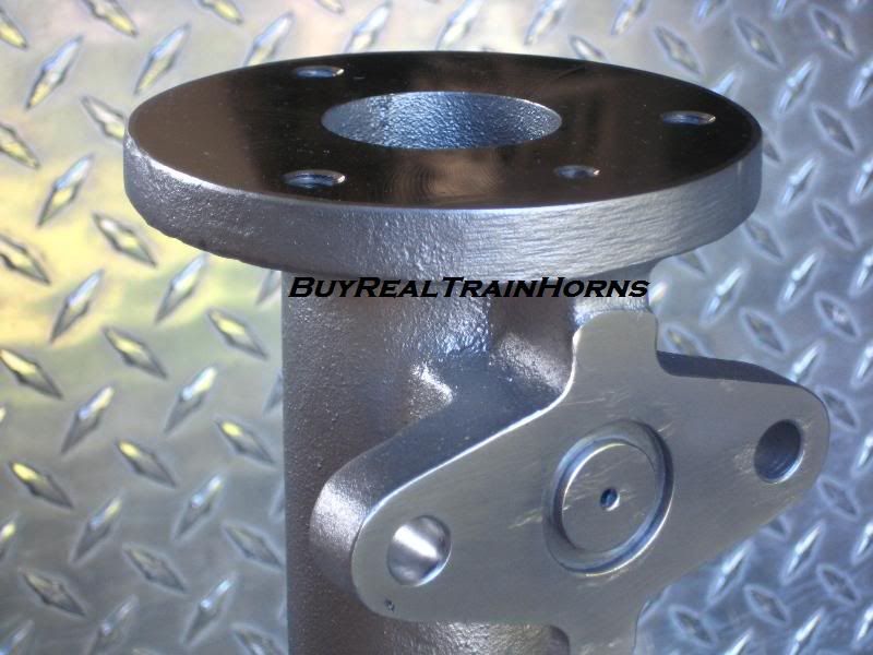

Wait, so how is it that realtrainhorns.net is selling a manifold bracket set for the k5, and the pics show fittings attached to each bell? Do these not work with my Nathan, I’m a little confused here. I will try and take a pic tomorrow of what I mean.
This pic is what I mean, how is the fitting attached?
I found a pic online of what I am talking about, the bottom of my horn that attaches to the manifold looks like this pic. So how big can I make the opening? I take it, I can’t add a fitting directly to the bottom of my horn, I need some kind of gasket in between?
This opening, how big can I make it?

The small hole at the base of the intake is not there to restrict. It’s a Venturi which speeds the air before it hits the diaphragm chamber.
Thank you for that, I’m just going to leave it as is. I was confused when I read something about Over the Road and how you can remove the restrictor, so I wasn’t sure what I was dealing with when I saw my Nathan’s like that.
