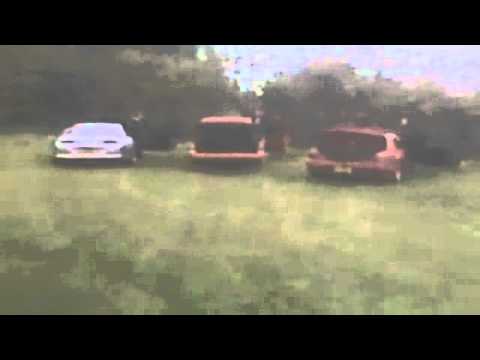

Though the quality of video is rubbish, here is a short vid of three out of four set’s of Horns I have owned.
Firstly you will hear a set of Seige 3’s (my first ever horns and I gave em to a buddy of mine.
Secondly, are my first ever shockers I owned and installed on a MR2
Thirdly are my K3’s - Totally annihilating the other two sets!!!
