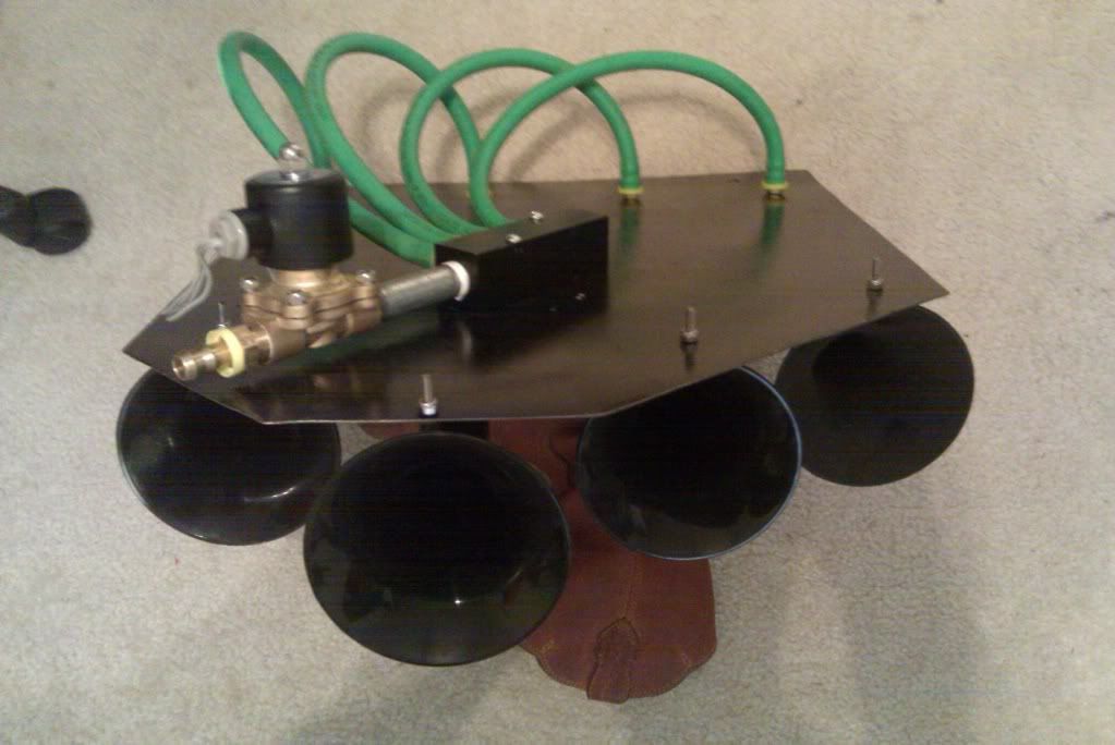

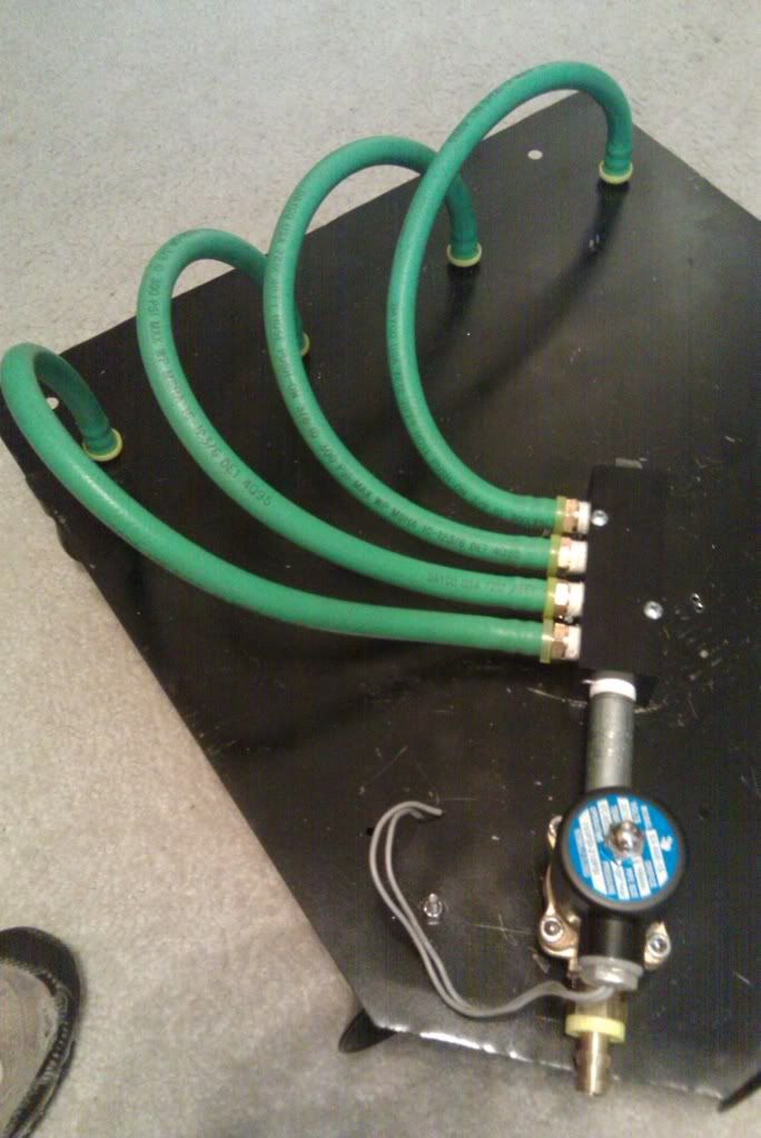

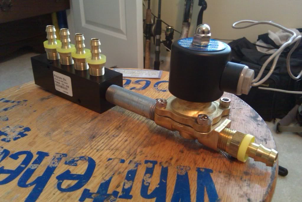

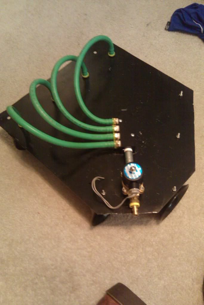

I installed everything back on the truck yesterday. I’m running push-on/push-lock fitting and 1/2" ID hose to a 1/2" air valve then to a 1/2" inlet port “log” style manifold with 4 - 3/8" ports. All of my hoses coming off the manifold are 19" long.
Problem 1: I laid into the horns really easy, but doing this yeilds a higher pitched tone(sounds like the shortest of all the horns) as if all the horns are going off at the correct time. With this being said would I need to shorten my hoses coming off the manifold due to the length of the manifold?

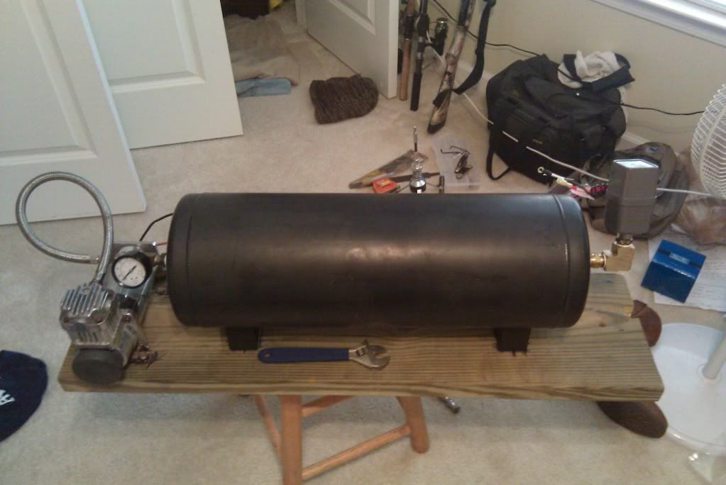

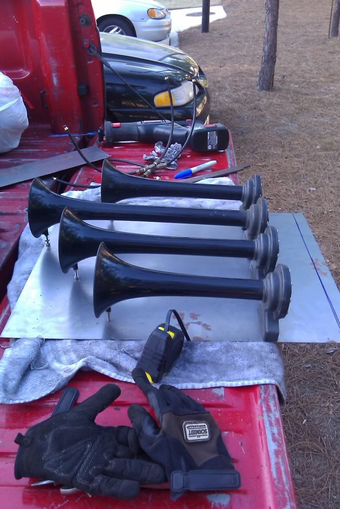

Here are some pics of my setup…My tank and compessor are in a tool box in the bed of the truck.
