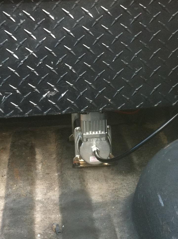

Well, I finally took some pics of my truck and install. They are not very good and were taken at night but I will get some better ones soon… Nothing special, truck has a Smarty tuner and a Goerend transmission. Stealthy is how I like it…
Here’s the rest… I have more on my phone to download tonight…

2 angle irons = bracket = win
One thing I’ve wondered about the brackets (I haven’t made mine yet) is tapping the hole for the fitting. Did you have to be real careful of the depth? If you tap too deep, the fitting would poke through & the horn wouldn’t sit flat. Did you just sneak up on it?
That is exactly what I did. Went about half way down the tap and checked with fitting. Once I knew how deep to go I marked my tap and did the rest of the brackets. Saved the 150$ for the brackets…worth it in my opinion
