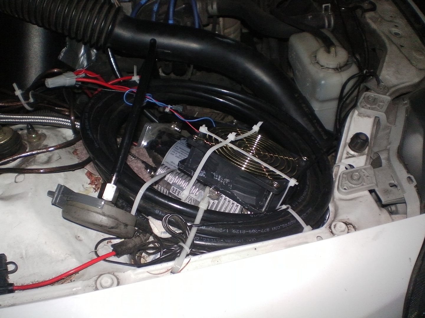

I now have a 150 amp ANL fuse about 4 inches from the + terminal on my battery along the 4 gauge wire.

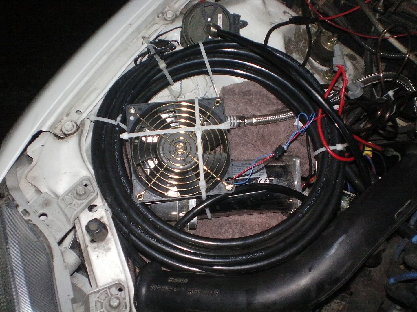

Also, I’ve added a cooling mod to my Viair 400c. 220CFMs of cooling from a 12V Delta fan. To put it in perspective, the Oasis XD4000 only has a 100CFM fan!

So does the fan just come on with the compressor?
Yep, just on when the compressor is on
