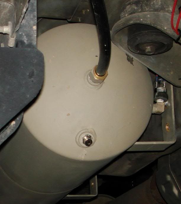

the 9gallons fit on the passenger side frame rail…right under the rear door…its a super tight fit unless u notch out a bit of the body mounts…i got it in there perfect.and it sits level so it looks nice from the outside…painted it to sorta match…and tucks up in there real nice
looks awesome bro

is there a drain on that tank? im not seeying one…
Yeah, if you dont have a manual valve on the leslies then I guess you have to put a long tube on em.
my tank??yes there is,its on the front end of the tank on the corner…i also have a air spiket to connect airhose to fill tires.run a tool…blow off the floor,the bed.
when i drain my tank i sit my driver rear wheel on a curb o whatever then open it…it tanks out all the water…which aint much…my compressors r in my fender vents so theres not water
Thats the perfect tank to have right there because you can side mount it and still have the drain plug facing down, vs. my tank which is like this:
