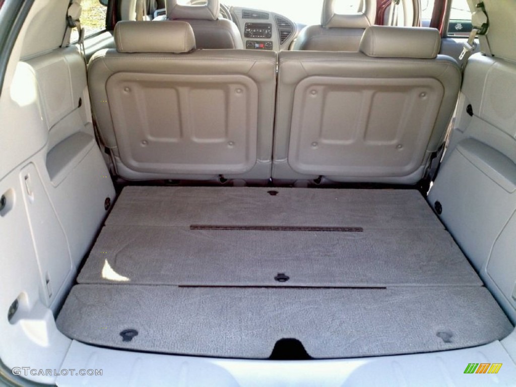

I believe that is the cxl version of the rendezvous Because I have only 4 seats total with actually quite a bit of room in the trunk.
This is what my trunk looks like. And I figured because I have space in the back for the compressor to keep the horns nearby.
The spare tire holder is under the car and I thought if I have the horns facing out let’s say to the right that the horns would not just amplify within the car But shoot out the side. Also when I took the spare tire off from under the car I planned to just toss it in the trunk.

Yeah… wow, that’s HEAPS of room. No problems there.
Nothing special about the board I used. The idea is just simpler so you don’t need to drill into or through the car floor to mount the tank and compressor. Just use a sheet of ply, MDF or any bit of lumber you have lying around.
Just have it thick enough so you can recess any bolt heads (from underneath) or get a firm enough grip with some screws. Then just one hole through the board and bolt it to the floor of the car. Another hole for your main air line leading to the solenoid and perhaps one more for your wiring.
If your spare wheel point is external with open air then, yea that’ll work. Don’t have to keep the horns and compressor close together. Use the supplied air line to run from the tank to the solenoid and then to the spider fitting that splits the lines. That can be at the front of the car if you have room there - no worries. From the manifold you just want to be mindful to keep the 5/16" tubing roughly the same length going out to each horn. That way they’ll all sound together.

To the op: remove some of those panels in the trunk area and see what kind of room you have in there. Or you might need to mount it under the car and the tank inside or vice versa. With the tank mounted on the compressor is gunna leave you LESS room to accomplish this mount in the best way.
