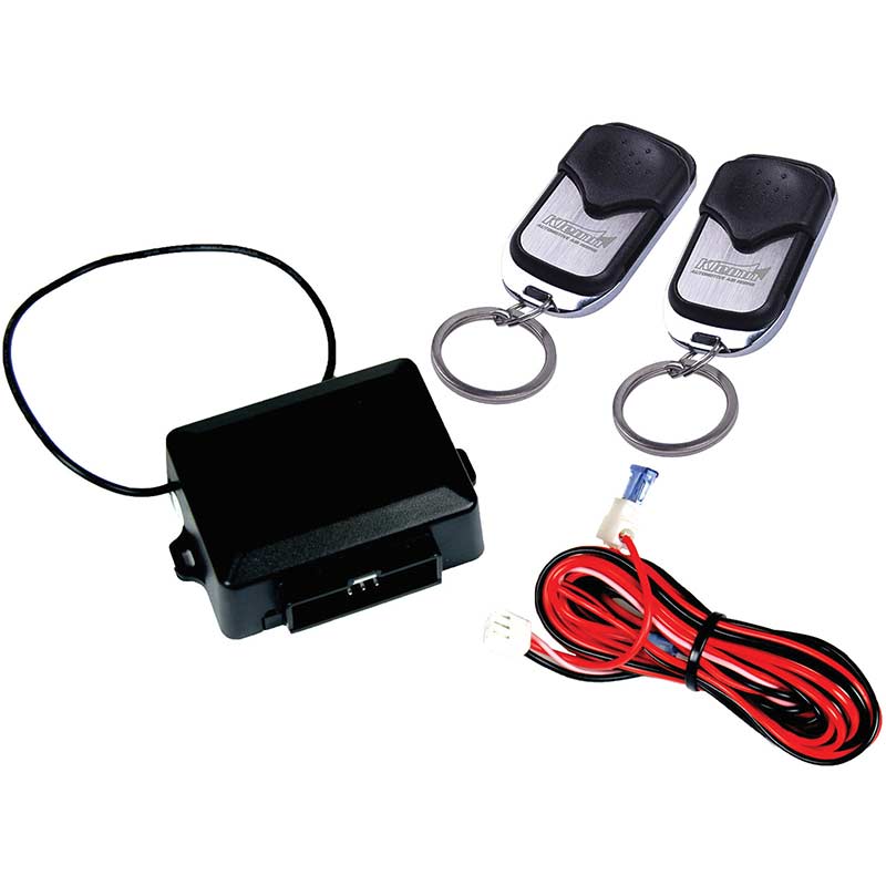

I finally got around to installing my remote for my train horn i will say it was worth it i used one off amazon “link below” My truck did not come with power anything so i added this switch onto my existing button on my dash. I mounted it as high as i could up in my dash to get the best distance.This one was very easy to wire up. there were two ground cause it was a on/off not a momentary switch positive and negative. and finally the antenna. It came all labeled so it made it easy to install. the range on it is about 150ft with a heavy woods in the way and i could get a maximum of about 200ft if i put to my head:p lol. After this I’m probably going to upgrade it in the future with a 4 channel for the compressor and a second solenoid.

Well my first remote died, it fried itself open so i took it off and went a different route and got this one off amazon reviews seemed nice and i could use both channels one for the each horn. my first remote only worked to about 200ft and this past Friday night i tested my new one and i got a range of about 650ft a little bit over 1/10 of a mile on a strait road with the antenna up in the dash. So im surprised it worked so well and i hope this one lasts

copes very well with interference its on 315mhz and I have tried to set it off with other remotes set to 315mhz and they have not set them off. the remotes are learned to the chip on the board “asked the company” so you would have to have on the original two remotes to control it. So that no random people set it off:D. its very close to Stinkypetes remote just different maker
