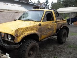

Another option for over the Cab mounting
I needed a mount that does not take up space because I use my truck for hauling.
I wanted to quickly add or remove the horn when needed.
So I went with a trailer hitch reciever mounted vertically against the front bed wall.
http://www.youtube.com/watch?v=SKBEFjD-oOM
Ha ha weld a plate to the top of the cab…
Like this:
http://www.trainhornforums.com/showthread.php?t=3243&highlight=leslie
