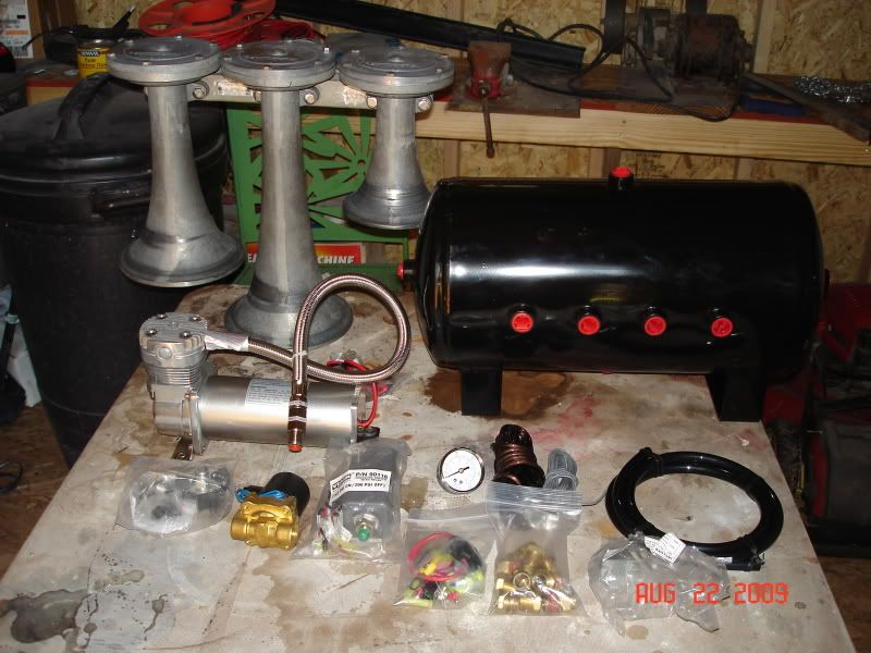

Well I went ahead and ordered an air kit from Hornblasters.com. Got everything on Thursday. So now I need to paint the horns and get it installed. I still have a few things left to get thought before installing. I went ahead and got the 165-200psi pressure switch, is that the one ya’ll use that have K3’s?
